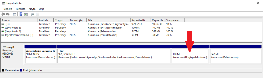

UEFI-tilassa ei toiminut yllä olevat komennot (kuva alla): "Failed to retrieve geometry for disk -1", vaikka virtuaalikoneessa on vain yksi levy.
UEFI-tilassa toimi alla olevat komennot (kuva alla). Muuta tarvittaessa levyn numero.
mbr2gpt /validate /disk:0
mbr2gpt /convert /disk:0

Jos järjestelmän varaama osio (system reserved partition) on kooltaan vähintään 100 Mt (tai 260 Mt 4K-sektorikokoisilla levyillä), käynnistä komentokehote Windowsin USB-tikulta, koska silloin MBR2GPT-komento muuntaa järjestelmän varaama osion EFI-järjestelmäosioksi.
Creating an EFI system partition​
For Windows to remain bootable after the conversion, an EFI system partition must be in place. MBR2GPT creates the EFI system partition using the following rules:
  1. The existing MBR system partition is reused if it meets these requirements:
    • It isn't also the OS or Windows Recovery Environment partition.
    • It is at least 100 MB (or 260 MB for 4K sector size disks) in size.
    • It's less than or equal to 1 GB in size. This size is a safety precaution to ensure it isn't a data partition.
    • The conversion isn't being performed from the full OS. In this case, the existing MBR system partition is in use and can't be repurposed.
  2. If the existing MBR system partition can't be reused, a new EFI system partition is created by shrinking the OS partition. This new partition has a size of 100 MB (or 260 MB for 4K sector size disks) and is formatted FAT32.
If the existing MBR system partition isn't reused for the EFI system partition, it's no longer used by the boot process after the conversion. Other partitions aren't modified.
If the existing MBR system partition isn't reused for the EFI system partition, it might be assigned a drive letter. If this small partition isn't going to be used, its drive letter must be manually hidden.
